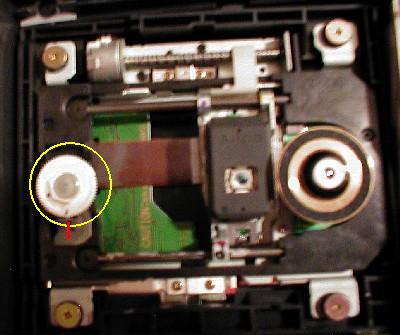

pancho Unregistered guest | adjusting the lens works i had the same problem and that did trick now it reads any game get info on how to adjust the lens before doing it |

Unregistered guest | I just fixed a PS2 for a friend last night. I couldn't believe it worked. He was getting "disk read errors" whenever he tried playing a DVD movie or a PS2 game that was on a DVD. His PS2 still read music cd's and games that are manufactured on cd's, so I knew that the laser still worked. I was knew to PS2 troubleshooting, and I found this guide, and it worked. No more problems. http://arstechnica.com/articles/paedia/hardware/ps2.ars I hope it works for you guys. Let me know. It is fairly simple to do. |

Fo Sho Unregistered guest | yo fo sho my ps2 is a scph - 50002 and ive ajusted it so it reads a dvd a silver ps2 game a ps1 and a blue ps2 disk but it only plays ps1games and da blue ps2 diks fo sho how da hell do i fix dis |
criff19 Unregistered guest | ok, i tried the laser adjustment....still no go....it seems that i get the browser screen when i click on it, then the screen goes blank, and thats it. When i adjust the laser, all it does is make it so i get the disk error prompt. so its either the error or no error but a blank screen. What the heck?? any ideas? |
