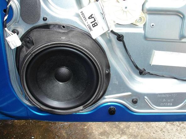

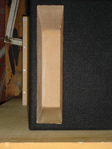

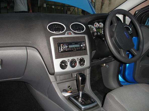

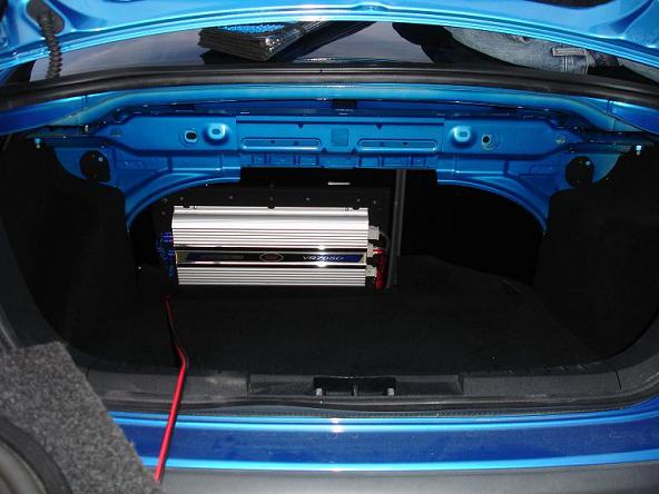

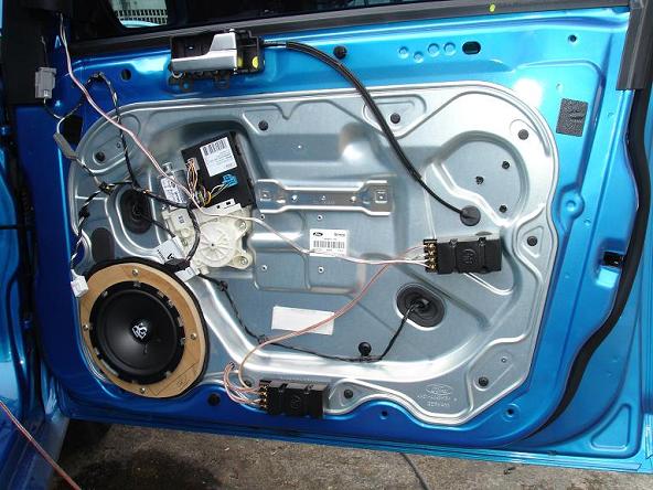

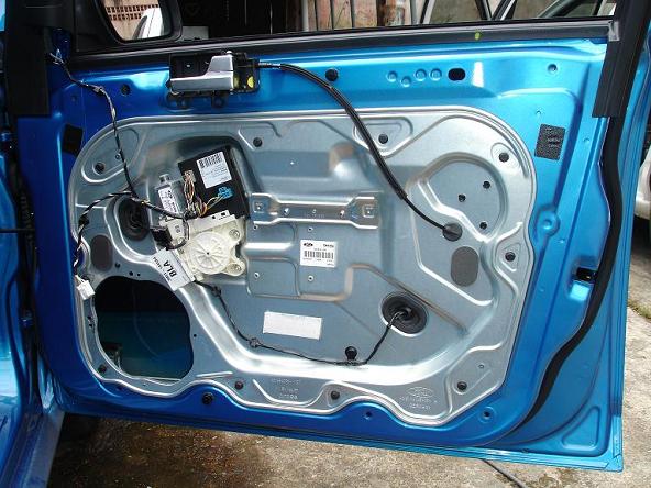

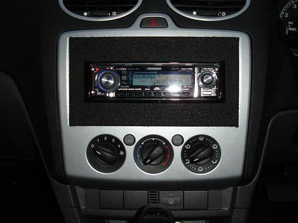

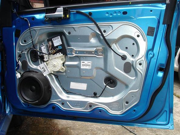

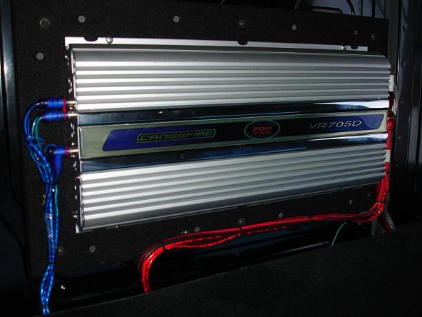

Gold Member Username: RovinTrinidad & T... Post Number: 8852 Registered: Jul-05 | Finished 2day doing a small install 4 some1 on a 2006 model Ford Focus -- car is about 3mths old Replaced stock HU with a Kenwood eXcelon KDC-X789 (his choice) Replaced stock Door speakers with some DLS Ref6.5" PS6 Placed 1 15" MMATS P2.5 400wrms sub in trunk 4" ported around 33 Hz approx , sub & port on slanted front of box which is about 2.8cuft Both sub/box & amp was both bought used in very good condition from 1st owner - HU & DLS r brand new Stock Double Din HU (4got 2 take out pic b4 i removed it) ![]() New HU in place - i made that black carpeted plate around it , $aved $25 ![]() Note RIGHT HAND DRIVE - thats how ALL cars in my country are ![]() Stock Door speaker ![]() ![]() ![]() ![]() What came out ![]() New DLS 6.5" goes in -- made a mdf frame 4 it which is padded by a piece of black carpet 2 prevent any rattle ![]() Notice how original door still looks even after new comp set went in ![]() 4got 2 take pix of the tweeters when i mounted it in the stock location Powering whole system is a Crossfire VR705 5 channel amp 50Wx4 RMS @ 4ohms with 300Wx1 on the sub check its birthsheet ![]() Amp Time ![]() ![]() ![]() Power wire/fuse on battery ![]() ^^^yes its screwed onto the air cleaner housing , engine room is so crowded that there was no other place i could see 2 mount it on , its attached securely/airtight & won't affect the engine in any way Damn -- in the hurry I 4got 2 take Front pixs of the box showing the sub , when the owner comes back around in a few days I will take pix of it then anyway its this sub ![]() http://www.woofersetc.com/index.cfm?fuseaction=product.display&Product_ID=2157 back of box but we faced it backwards after pic was taken ![]() Was getting dark so here r a few quick pix of the car ![]() ![]() ![]() ![]() well there it is folks - no need 4 me 2 show u wires cause all have been neatly hidden under trim/carpet & u will never know/ see that its there Sounds quite loud with a slight trunk rattle & front windscreen vibrating a bit noticeably but clean & the difference over stock 'system' & new real system is like night & day ... ......owner was pleased...... ![]() |

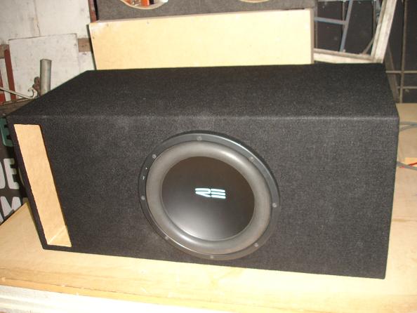

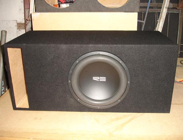

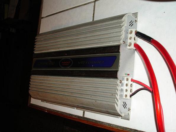

Platinum Member Username: Rovin1 12 Premier... Post Number: 10329 Registered: Jul-05 | just a lil update 4 those who may have not seen it on another thread : new sub/amp upgrade ![]() ![]() ![]() i built this box 4 the car owner - 1 12" RE SX ![]() ![]() ![]() ![]() ![]() ![]() with some seconds of installing it the rear part of the hood liner where the 3rd brake light is also attached ...just dropped down ! ,damn thing came loose instantly .....no lie ! ..... ![]() |

Gold Member Username: LbecknerTulsa, Ok Usa Post Number: 1426 Registered: Oct-04 | Nice install Rovin, but it looks to me like you ran the power wire right beside the hot engine without any splitloom. Isn't that a bad spot? Seems like the heat would endanger the integrity of the wires insulation, but thats just me. Nice job though. |
Platinum Member Username: RovinNew sub : 1 ... Post Number: 10388 Registered: Jul-05 | ^^^thats a good point - its supposed to have some loom over that wire but we didnt have any around since it was wk end & shops here were closed & we just forgot all about it -lol but by mth end maybe we r gonna upgrade that 4g to 0g since we upgraded the sub\amps ....... ![]() |
