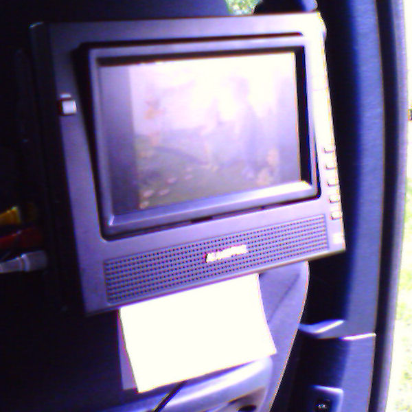

We have had our Audiovox DVD for about a year now and it is used everyday. We travel quite a bit on the weekends so it has definitely come in handy with no troubles. Until about 3 weeks ago, that is, when we started encountering the "skip to the beginning" problem. Now we can't get through very much of a movie without it skipping back to the beginning. It's so frustrating and you can surly relate. I guess I should be happy that I got more use out of it then others, but still, I want it to work again. I called Target with no help. I called Audiovox and it can be fixed in 4-6 weeks if I ship it to them and pay $40. Before I do that or just buy a different one, has anyone tryed anything at home to fix the problem and been successful? I am hoping there are things I can try here that could solve the problem for me without sending it off to Audiovox. Who says if they fix it that it won't break again in a couple months, then I have wasted even more money.
Any solutions?
Thanks!

As you might have read earlier, I had the same exact problem. I agree, very frustrating.
I managed to find out what the problem was with mine without having to return it, or crack it open and tinker with it: (Please forgive my long-winded explanation.)
If you open the DVD unit from a normal viewing orientation, you will notice a small plastic tab on the upper left side of the back of the screen. This tab is suppossed to make contact with a button on the 'base' of the unit. You'll see the button on the lower left-side of the base.
The tab and button combination is what lets the DVD player know if it is open or closed. What I noticed one day, is that if a DVD is playing, and you open, and then immediately close the unit, it skips back to the beginning of the movie.
I tried a quick-and-dirty test to see if this might be the problem. I placed a very small piece of paper over the the button, and carefully closed the screen, making sure the tab and the paper made contact with the button.
Sure enough, the DVD player stopped skipping. I played a movie, shook the player as hard as I could, and it didn't skip once.
Obviously, stuffing a little piece of paper in your DVD unit every time you want to watch a movie is not an optimal solution. I was considering gluing a very small piece of plastic onto the tab, or maybe finding a very small rubber cap to glue onto it. I haven't tried either yet, but I'm pretty sure that will fix it for good.
I also considered putting a small piece of tape on the tab, but I was reluctant to put something sticky in the unit. My fear was that if the tape slipped off, it could get stuck in the read head, or maybe get glue over the lens.
I hope this helps!

Thanks Dan for your help! I tried the piece of paper trick and put a towel under the player unit for added cushion and we had three skip free rides today! Woo hoo!
I am thinking maybe a small piece of eraser slipped on the end of the plastic tab might work??
Anyways, thanks for the help. These temp solutions will definitely work until I get my new van with the dvd already in it!

Just a note for those of you having the problem of the DVD skipping back to the beginning. I was cutting up an expired credit card and decided to cut a small piece and glue (super glue)it to the "button" that gets pushed in when the unit is closed. I used a piece with a raised number to get the extra thickness. My daughter watched a movie in the car yesterday for 2 hours and it never skipped. I hope this solves the problem as this is a great unit otherwise!!

That was a great idea; I wish I had thought of it myself. I ended up buying some eyeglass nose pads, and trimming one down to the size of the "button." The adhesive on the pad was strong enough to stick to it, and it's worked well in the house. I haven't put it back in the car for a road test yet, though.

Hi all,
Well I was looking about skipping problem of this unit and found this thread.
I looked into Dan Reno's solution and then I found that actual problem is on hinges.
So to test it i placed a folded piece of paper and it works great.
I had to come back and share my findings as I know how annoying this skip problem is.
I also got a picture with my phone to share it just in case its not clear where to place folded paper.
I did attach a picture on my post here, but here is link of the picture hosted on my sons web space:
http://hektorbuqaj.home.comcast.net/~hektorbuqaj/audiovox.jpgUpload
