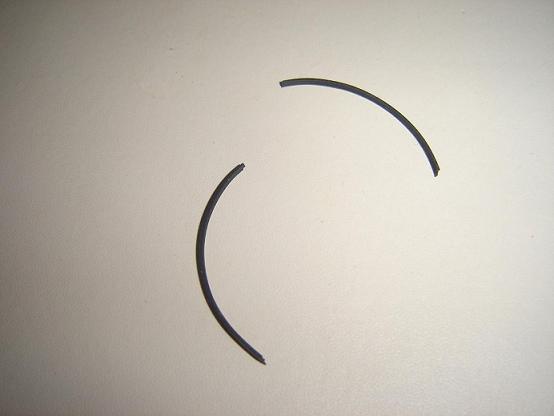

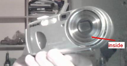

I found that the real reason of the failure to move as it should of the lens is also mechanical: it involves the wrong positioning of a black rubber o-ring located between the inner and the outer moving sections of the lens.
Why the rubber goes away from the correct position can be related to sand and dirt but more probable to the presence of humidity. Once the rubber is misplaced it generates the error because it avoids the smooth movement of the lens.
[With the black box of the gears open I had to do a lot of force to move the lens, of course the small engine cannot manage it ...]
Now why people claims that they have solved the problem in this "geared" way?: because in the process of "hypothetically fixing the gears" they move the lens by hand more easily (once the black box is open) and most of the times the o-ring will go alone to the correct position, in this case they never see it, because the o-ring is inside ..
In my case the o-ring was so badly misplaced that at some point I was able to see it appear at the boundary of the 2 moving pieces...
I pull it out, I broke it and I extracted one part ... then the camera worked fine for a few minutes...started to fail again (because I had extracted only a portion of the o-ring) and after moving with my hand helping the mechanism many times the other extreme of the rubber appeared...I was able to extract the remaining and now everything works perfectly well....
