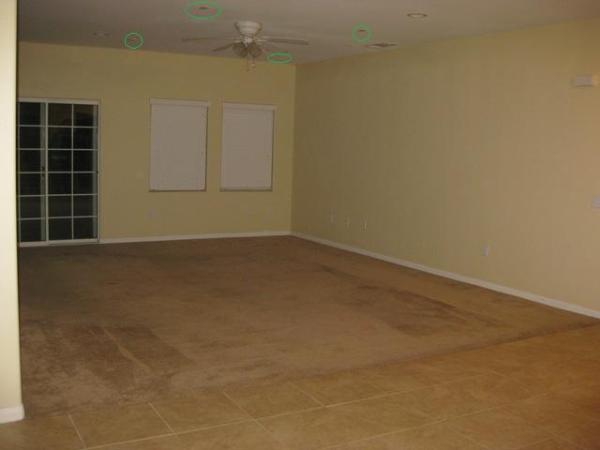

Gold Member Username: Loc_outSoCal Post Number: 3048 Registered: Feb-05 | You got that right Brad surround sound. Sorry I wasn't being clear. Would those Dayton work in a home theater setup? Below is a picture I took last night. The green circles are where the speaker would go. Any advice would be helpful. Thanks again for all the help. ![]() |
