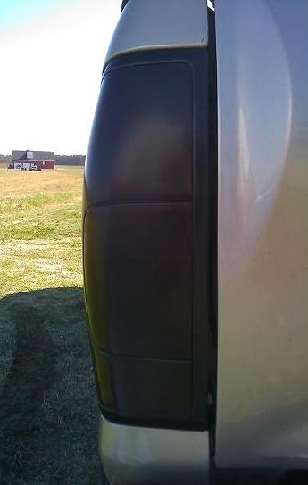

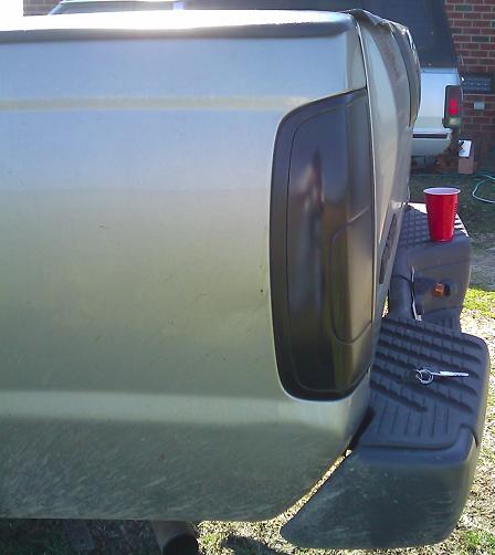

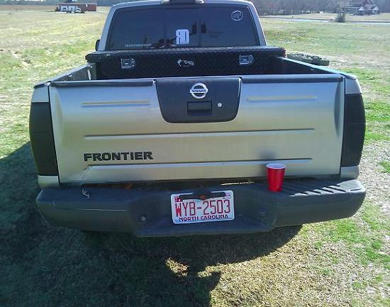

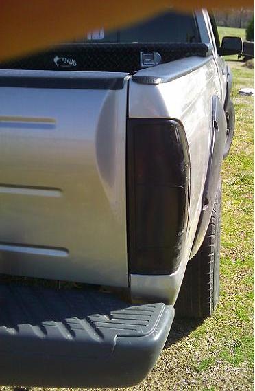

Gold Member Username: ShortysetniesAndrew Capps, NC US Post Number: 3245 Registered: Mar-06 | Your link isnt working for me either. Haha. If it says VHT Niteshades and the majority of the can is purple, thats it. Works great. Take the tail lights off the vehicle, lay them flat and make the coats VERY VERY VERY light. Let it get tacky and spray another light coat on. Repeat that until they are as dark as you want them. SOme people clear them, some dont. If you look at my hit and run thread, the last picture I posted has my tail light done up with the VHT |
Gold Member Username: ShortysetniesAndrew Capps, NC US Post Number: 3246 Registered: Mar-06 | I can get more pics if youre interested |

Gold Member Username: JtownTexas Post Number: 3663 Registered: Mar-07 | more pics would be cool, I just ordered a 10oz can last night. how many coats did you put? your tails look pretty dark. if I stick with one or two coats, can I add additional later, say a few months down the road, if I so choose? |
Gold Member Username: ShortysetniesAndrew Capps, NC US Post Number: 3249 Registered: Mar-06 | Yeah. You can tint them later and you will be fine. I can go ahead and tell you, if you do the coats LIGHTLY like you have to, you will need 3ish before you can even tell a difference. I did 10ish to get them pitch black. Again, I cant stress enough. LIGHT COATS or you will be looking for lacquer thinner to get rid of the runs well pics tomorrow. I just realized I dont have any. heres a vid though to hold you over... Not a good one of the taillights, I know, but oh well |

Gold Member Username: ShortysetniesAndrew Capps, NC US Post Number: 3252 Registered: Mar-06 | here it is again. haha hello finger ![]() |
Gold Member Username: Mrskullz1Brooklyn, New York Post Number: 1073 Registered: Feb-07 | nice, u recommend doing headlights with this stuff? |
Gold Member Username: JtownTexas Post Number: 3667 Registered: Mar-07 | damn that is pitch black, I may not be going that dark, but I'm definitely impressed, thanks Capps. |
