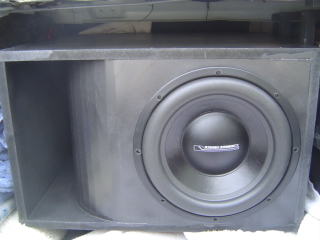

Silver Member Username: Bjfish11Garden Plain, KS USA Post Number: 323 Registered: Dec-06 | Here is another one I am working on. Just havent had the time lately. But you can follow along if you would like.... http://www.caraudiojunkyard.com/forum/fisher-customs/2472-box-build-one-myself.h tml |

Silver Member Username: CblazeRock island, Tenesssee Us Post Number: 840 Registered: Sep-07 | thats nice i never knew u could bend mdf either,if thats what your using |
Gold Member Username: AdddisorderPalm Beach, Florida Post Number: 5614 Registered: Jan-06 | ![]() yup you can chris. |
Silver Member Username: CblazeRock island, Tenesssee Us Post Number: 845 Registered: Sep-07 | kool.just prolly aint easy |
Silver Member Username: Nickyp0219Post Number: 231 Registered: Jun-06 | mat, how did you get your box to look like that? |
Gold Member Username: Nd4spd18Northwest PA Post Number: 4589 Registered: Jul-06 | It's pretty easy. I hear all you have to do is soak it in a pool................ |
Silver Member Username: CblazeRock island, Tenesssee Us Post Number: 853 Registered: Sep-07 | m.s. im not trying to piss u off but why do u always have to have a smart azz answer |
Gold Member Username: AdddisorderPalm Beach, Florida Post Number: 5617 Registered: Jan-06 | its called kerfing. basically you just calculate the amount of bend you want and then make some cuts in the wood where you want the port but only go like 3/4 threw the wood and take it easy and bend it. definatly practice it first. if your really interested i can get you more details if you cant find any. |

Gold Member Username: AdddisorderPalm Beach, Florida Post Number: 5620 Registered: Jan-06 | thanks ray and BJ nice looking box what, kinda car is it going to go in it looks huge? |
Gold Member Username: JtownTeam Revolution, Texas Post Number: 1220 Registered: Mar-07 | I'd like a link with more info on how to calculate the radii for kerfing....if it's not a problem |
Gold Member Username: AdddisorderPalm Beach, Florida Post Number: 5623 Registered: Jan-06 | the forum that had the post that told you how to do all of that is either down or compleatly gone. i did find this to give you an idea. DIY_14394_2270528%2C00.html,http://www.diynetwork.com/diy/tl_saws/article/0,,DIY _14394_2270528,00.html after you find where you want the bend to start, you just cut the inside and however you space the cuts it what determins the bend. i THINK 1/2" spacing will give you 4" of flare but i dont remember for sure ill look later tonight when i have more time for it. |
Gold Member Username: JtownTeam Revolution, Texas Post Number: 1239 Registered: Mar-07 | that link just brought me to the DIY home page I'm thinking ![]() |
Silver Member Username: Bjfish11Garden Plain, KS USA Post Number: 326 Registered: Dec-06 | Its going in an ext cab Silverado, in place on the rear seat... No chlorine invloved in this build ![]() |

Silver Member Username: Nickyp0219Post Number: 233 Registered: Jun-06 | mat, i meant how did you give it that black look? whatd you put on it? |

Silver Member Username: Nickyp0219Post Number: 235 Registered: Jun-06 | i love how that box looks mat, prol wont be able to do that bend right away but i can start with the color =P |
Gold Member Username: AdddisorderPalm Beach, Florida Post Number: 5626 Registered: Jan-06 | ohhhh black spray paint ![]() |
