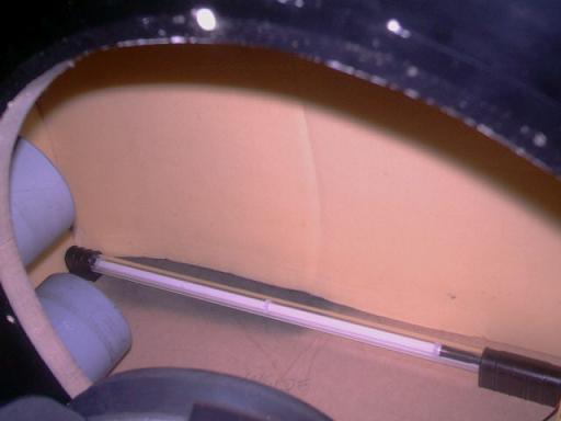

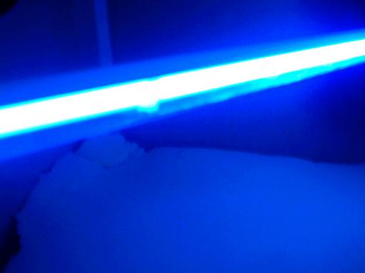

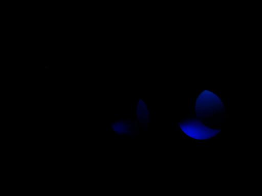

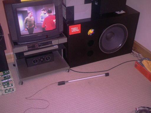

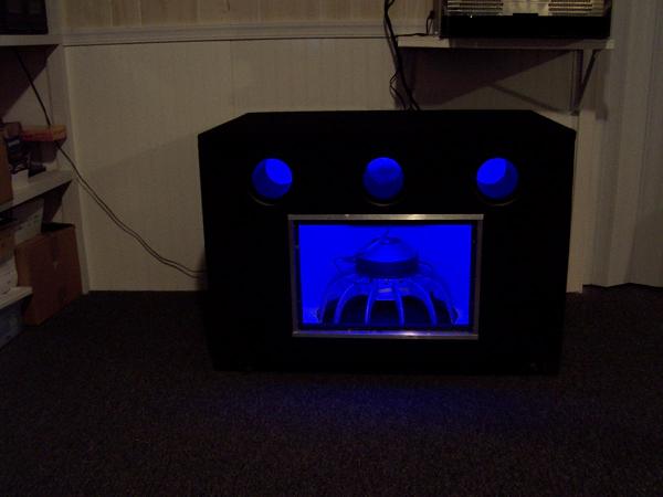

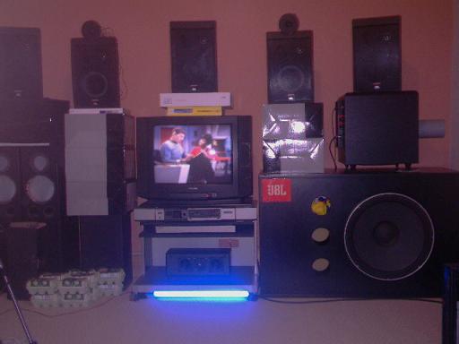

Gold Member Username: Thx_3417Bournemouth ... Post Number: 3312 Registered: May-05 | LOL, I didn't know what on earth to call this thread, so there it is. Well I placed the blue 24" neon tube inside at angle and was disappointed with the illumination from the three ports. I guess it was the angle of the neon tube I was hoping for a bright even colour from each port. Oh well trail and error I guess some type of refection of the light inside the enclosure is needed or several small neon tube. Don't they do circular car neon tubes? That would work when placed near to the ports. Anyway since I've read Paul's sub bass baby thread of doom! Where I did find neon light an inspiring idea I've had to remove the neon tube and place it back underneath the TV monitor. Well I must say you had luck on your side with placement of the blue neon light, damn. ![]() ![]() ![]() ![]() ![]() ![]() ![]() ![]() ![]() Here it is back underneath the TV monitor. ![]() Here's a little Big Trouble from early this week, I like the colour that neon light does. |
Gold Member Username: Arande2Extreme SQ FTW Post Number: 2184 Registered: Dec-06 | You could try painting the inside white...might take too much work though. |
Gold Member Username: WingmanaliveA pic is worth 1000 words Post Number: 5129 Registered: Jun-06 | The inside is dampened right? Sux. Yeah the white paint would help tons, just not with the damping. ![]() |
Gold Member Username: Thx_3417Bournemouth ... Post Number: 3314 Registered: May-05 | You absolutely right well that's going to be very difficult now, still it was nice try. You absolutely right well that's going to be very difficult now, still it was nice try. |
Gold Member Username: Thx_3417Bournemouth ... Post Number: 3315 Registered: May-05 | Yours is looks way much nicer on the uniformity of the colour lighting the interior of the sub up. |

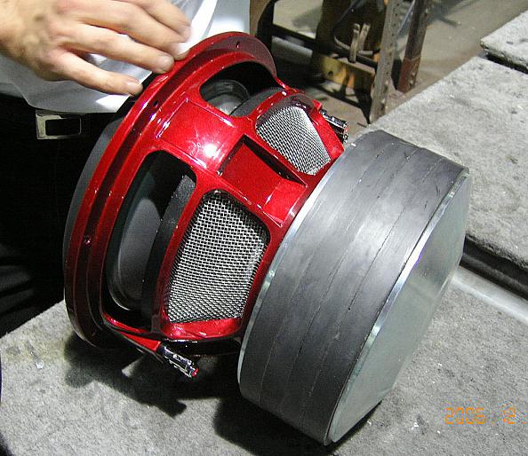

Gold Member Username: Arande2Extreme SQ FTW Post Number: 2188 Registered: Dec-06 | Oh hey Paul... $800 ![]() http://www.soundprofessionals.com/cgi-bin/gold/category.cgi?item=PH-XP-5000 |
Gold Member Username: WingmanaliveA pic is worth 1000 words Post Number: 5136 Registered: Jun-06 | ![]() |
Gold Member Username: Arande2Extreme SQ FTW Post Number: 2191 Registered: Dec-06 | That powering 1 of these? http://www.tcsounds.com/lms5400.htm It's more an SQ driver... I'm sure you've seen it before. You'd have to run it with a channel on each VC (so 2 amps) for 10kw or settle for 2.5kw. Just an option... http://www.tcsounds.com/forums/index.php?showtopic=577&st=0&gopid=4850&#entry485 0 |
Gold Member Username: Arande2Extreme SQ FTW Post Number: 2192 Registered: Dec-06 | ![]() |
Gold Member Username: WingmanaliveA pic is worth 1000 words Post Number: 5137 Registered: Jun-06 | Yes yes. Pics on that forum don't work though.![]() Quad stacked magnets, FTW! |
Gold Member Username: Arande2Extreme SQ FTW Post Number: 2193 Registered: Dec-06 | ROAR! |

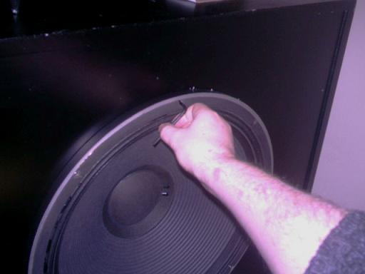

Gold Member Username: WingmanaliveA pic is worth 1000 words Post Number: 5139 Registered: Jun-06 | If it were me, and it's not, on a sub that beefy I would have to bolt it to the box. Screws just wouldn't cut it for me.![]() |
Gold Member Username: Arande2Extreme SQ FTW Post Number: 2197 Registered: Dec-06 | With that sub...I'm sure you could use dual 18inch PRs (recommended because the port size needed to not chuff with this driver is HUGE!) and tune it to maybe 10hz to get (calculating...let's see) around 120dB output at 10hz...and do that with LMS technology. RUUUMBLE. |
