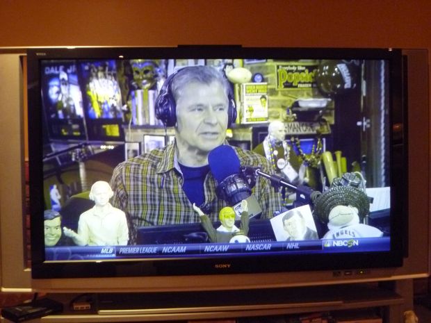

Thanks for the response. I will try the color filters approach. I seemed to go gradually as though it were a lamp issue, the picture is good other than the lack of red? How is it the old TVs last for years and the newer more expensive ones are crap?
Picture attached for anyone's comments. As you can see the lack of color definition on items in the background is apparent.Upload

Lamp will lose BRIGHTNESS over time and then simply Cease to Function. 7000 hours PLUS should be normal.
Colors typically won't shift as the lamp ages.
You MIGHT want to go to youtube and check out the disassembly videos for your particular model. Sony sets are very well put together and my ONE experience with 'em found it to be easy to work on. Just all those darn PLUGS�.with which you MUST be careful.
Sony LOST 2 or 3 class action lawsuits concerning this set due to inferior filters used in the light engine.
If someone has heat-proof glass, that's the way to go.
