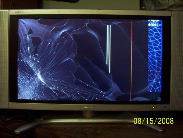

New member Username: Eng2007Post Number: 1 Registered: Aug-08 | Hi, If anyone is interested I have a working Sharp Aquos LC-32DA5U for sale with a broken LCD screen. I believe, from research, that parts are compatible with the smaller lc-26da5u and i think they will work with lc-32d4u but please confirm. Please private message me, I am located in Toronto. ![]() |
