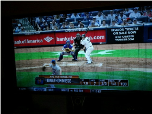

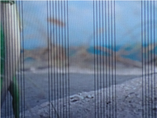

have vertical thin black line issues,was abe to watch for long periods up until a few days ago,now the picture goes out after about 5-10 minutes,based on the photos anyone have ideas onthe problem,thank you

Upload if possible can a technician explain the problem here

I'm no expert:
It looks, however like 1 of 2 things.
Either: the DLP chip itself is defective....not very likely...
or
The circuitry driving the chip has a problem.
I don't think a color wheel or lamp problem could produce such an effect.
DLP is a Pain in the XXX. Since this is an older set without even an HDMI input, I'd simply junk it out and get something newer with such inputs and full 1080 resolution.
It won't 'stay' fixed, either. The color wheel is prone to failure and the part has been thru many revisions to try to help. Lamp wiring is another problem. I'm less than clear on this, but many people replace ballast boards as a result of hi-resistance connections frying the board......
Cooling fans of which there are 3 or 4 may also clog with lint and the set'll cook.
You should be able to replace the set for 700$ in the same size plasma.
