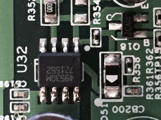

Username: Danomi
Registered: Sep-15
I'm having the same issue as original post. I see U32 on the board with all the video and audio connections on it. There a similar part that very close to it that there is so many numbers around that I don't think it's labeled
Thanks for your Help!!
Dan
