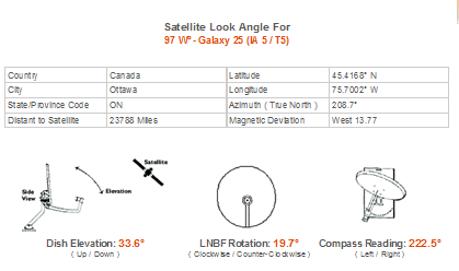

Your Receiver Setting for Galaxy 19 at 97.0°W
seem to be OK. Try this, point your largest dish
to Galaxy 19, the dish from your location must be
at lest 33" a 36" would be better with a Linear LNB
From your location Ottawa, Canada use these settings
