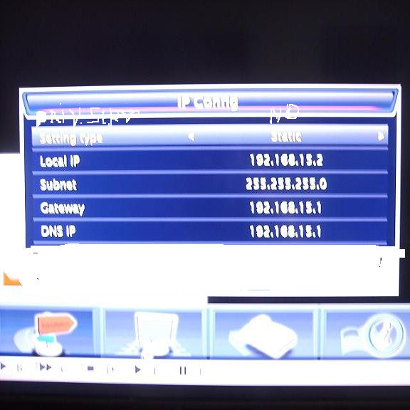

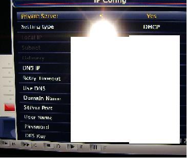

can you do show me your ipcofig on your recive.sir befor i was using privet server.now i want to use public server. actually i thing i have problame here.i want to show you my ip seeting setting DHCP retry time out 3 use DNS yes domain name(please tell me) server port 1920 user name?00000000000000 password0000000000000000 des key-00000000000000000000000000
Public server is easy no has user name, password nor des key look like this, if you want send me a PM with your e-mail address , Look the picture, the setup have to be on static,then change to dhcp there only change retry to 12. but you need to have ihub 2.2 on your receiver.
can you do show me your ipcofig on your recive.sir befor i was using privet server.now i want to use public server. actually i thing i have problame here.i want to show you my ip seeting setting DHCP retry time out 3 (12) use DNS yes domain name(please tell me) only for private server user name?00000000000000 only for priv. serv. password0000000000000000 only for private serv. des key-00000000000000000000000000 only for private server this is wrong you have to said NO to private server. like the photo

the setting you are showing is for private server, you have to said no to private server, now follow this
