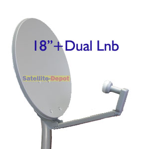

For this new out-building setup, I will be using an array of three "old-style" dual-output lnb dishes to tune 119W, 100W, and 129W individually. These three identical dishes have been used successfully in DTV and DN setups in the past. Upload
My question:
What type of switch will be required to combine these three dishes and send the resultant signal to the receiver (vip211k)?
From what little I have gleaned so far, I think I will be needing a SW64. Is that correct? And if so, will I need to "insert power" to it? Or will this one receiver work without the power?

1. You will not need a power inserter - the vip211k will power it.
2. The vip211k is a high quality HD DVR. You need to inform us about the LNBs. Your information "three "old-style" dual-output lnb dishes to tune 119W, 100W, and 129W individually." suggests the possibility of using a DP34 or DP44 switch, but more information might clarify that issue.
3. You said "119W, 100W, and 129W individually" I presume you meant "119W, 110W, and 129W individually".
In general, I can say that the direction you are taking of marrying this high quality new receiver to three old LNBs is feasible, but not necessarily desirable. A Dish 1000 unit would be more appropriate for this beast.
