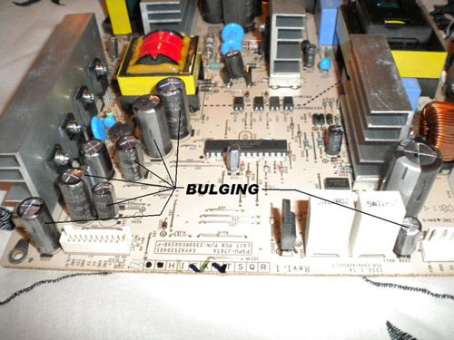

I have a VP322 32" Plasma TV that is about 1.5 years old (so obviously out of warranty.) I already know it's the capacitors that need replacing and even know the ones that need replacing. *grin* Not bad for a girl, eh? haha
This is the list I have and the location of the capacitor:
Loc. ---V --uF -Temp.
C233 10V 3300 105 C(M)
C234 10V 1000 105 C(M)
C236 10V 1000 105 C(M)
C204 25V 1000 105 C(M)
C205 25V 1000 105 C(M)
C238 10V 470 105 C(M)
C241 10V 1000 105 C(M)
Those are all the capacitors that need replacing. I have been to several electronic stores in my area and no one... and I DO mean "NO ONE" has the parts I need. I want to purchase parts that are comparable, but have a higher temperature threshold because obviously that is the problem. There's no point in me replacing bad parts with the same parts that are also going to go bad in only a matter of time, so I want to replace the parts with a higher tolerance, higher temperature threshold, and if I have to use a higher voltage that's fine as long as I get the other two conditions.

replace the 3300 uf 10v caps with larger 16v or 25 v
