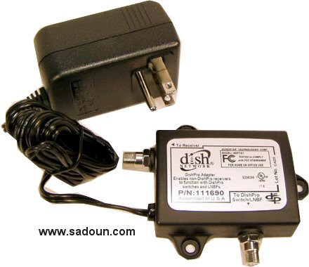

I have uploaded the picture of the DP adapter for you. you connect this to the wall. It says on it "Dishpro adapter enables non dishpro receivers to function with dishpro switches and LNBFs.
