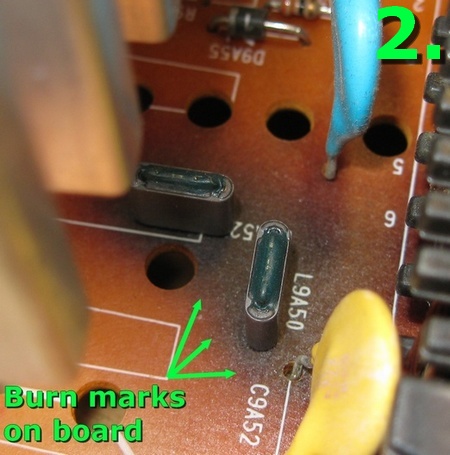

I have a Mitsubishi WT-42313 rear projection HDTV. When I press the power button I hear a "click" and the green power light comes on, approximately two seconds later the light goes out and I hear the same "click". The screen never lights up, and the power light is not on long enough to do the "menu + input" error code trick.
I opened the TV up, looked around and noticed something labeled "IC9A51" (listed as: HIC - SE110N in the service manual) had grey "goo" that was pushed way up in the plastic tube, and the bottom of the tube seemed brown/burned (see picture 1). I also noticed what looks like burn marks around several components on the board (picture 2). I was hoping that by looking, someone could tell me if these are related to what's wrong with the TV.

I installed a replacement for the "IC9A51" (listed as: HIC - SE110N in the service manual), unfortunately it didn't fix the problem. At this point replacing other parts would just be guess work, so unless someone can suggest another course of action, I'll hold on to it for a few more days then take it down to the recycling center. I was hoping to have a solution for anyone else having the same issue, but the good news is, it appears this problem is rare.

Meanwhile, I tried to play around with the suspect boards. I noticed when I tried to push down the board at the center and then turn it on, the TV would remain on for like 1 minute but then turn off. If I don't push down, it would turn off after only 1 sec. Very strange but I concluded something is wrong with the board. I also did a close inspection and noticed the same burnt marks that Craig reported in his msg, around the same components (inductors) he pictured. These are the same components surrounding a transformer around the center of the board which is actually the transformer I was pushing down that somehow caused the TV to remain on for unusually longer time. I think there may a design problem that causes these inductors to burn out and fail faster than they should on certain Mitsubishi TV models like ours.
