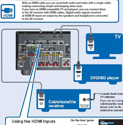

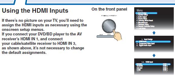

That's how I have my hdmi cables connected. I could understand the issue if I had nothing at all showing, but seeing the directv menus, channel guide, etc is strange. If there was no connection at all, obviously I wouldn't even get that.
