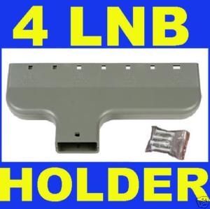

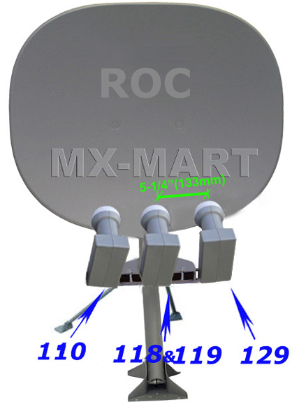

On the bev dish I have 82, 91 aimed. On the ellipitical I have 110, 119 aimed. I tried to get 129 aimed on the ellipitical as well but Im having no luck with that 4lnb bracket. Would this curved kind of bracket work? I saw it on ebay.. it claims its guaranteed to work. Just wondering if anyone has tried it before.
