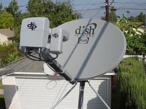

Hi,
I have dish 1000 pointed at 119, 118, 110 using dp34 switch. When I scan I am missing zee tv, ndtv,TV9 and few others. When I scan i get about 201 channels.
My settings for 118 are:
LNB: single
frequency: 10750
diseq switch: 3
It's strange I can get see these channels in pansat 3500 and nova but not kbox.
Any help appreciated.

Username: Loverboyz
Post Number: 60
I tried everything still can't get it to work.
If I put this settings:
LNBF Type: single
frequency: 10000
Diseqc switch 1.0: 3
LNB power: ON
LNB 22khz: OFF
I get channels channels ndtv, tv9,and sab
If I try
LNBF Type: single
frequency: 10750
LNB power: ON
LNB 22khz: OFF
I get channels sahara samay, start plus, start one, sony, set max, b4u music, zee cinema, tv asia.
Please help I am tired of switching dish setting to see different sets of channels. As i said earlier i am using dish 1000 33' catching 119, 110, 118, with dp 34 switch.. Also my nova and pansat3500 are working fine.. able to catch all the channels with one settings.

Username: Loverboyz
Post Number: 62
My nova settings are set to
LNB: SingleDPLNBF
Lo Freq: 10750
22khz : OFF
DiseqC 1.0: Port 3
Here I can see transponder 12002 H 20.00mhz
signal 77 quality 90. My kbox gives me signal 50 quality 20 percents. It's really weird. I am going to try resetting everything. Hopefully it will work after that.
But please share any ideas u have.

Username: Loverboyz
Post Number: 63
I have 2 lnbs, 1 is dual and 2nd is single i believe
3 cables coming out of those lnbs.
2 from dual and 1 from single.
119 connected to 1
118 connected to 3
110 connected to 2

Username: Plymouth
Post Number: 10222
John
Ok you have a Dish Pro
That's why it not work!
Try this setting:
LNB: SingleDPLNBF
LNB freq: 10600
hook your 118.8 LNB on port 1 of the switch, you must use 22khz : ON, 119 use same port 1 but you set it on LNB: DPLNBF, LNB Freq: 11250.
You must hook only one cable on the big LNB.

Username: Loverboyz
Post Number: 65
Ok I was able to get ndtv, sab tv, star plus, star one, zee tv, zee cinema, set max, tv9, and headlines today by manually adding transponders using dssrookie site. However I am missing sony, tvasia, sahara one, b4u movies, aaj tak, samay. Can you please post your transponder settings for these channels. I am looking at lyngsat they are supposed to bet at 12033. For me it should be 24600-12033 = 12567, but when i scan 12567 i get zee tv and other channels but not these. I am thinking may be lyngsat info is outdated.
