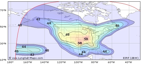

Do only a TP Scan, ( 11984 Pol. V Sr 8681
FEC (auto)
I am in EIRP 46, it's little hard to make out but
if you are in 42 you may be little out of range
with your 39" Dish from Quebec.
Here is the Footprint Map. check it out yourself
Username: Bernardmi
Post Number: 594
oldPlymouth I am between the 46 and 48 line. So I presume 47.
It should take me a 65-85 dish (26 to 34 inches). So I am OK at 39 inches.
