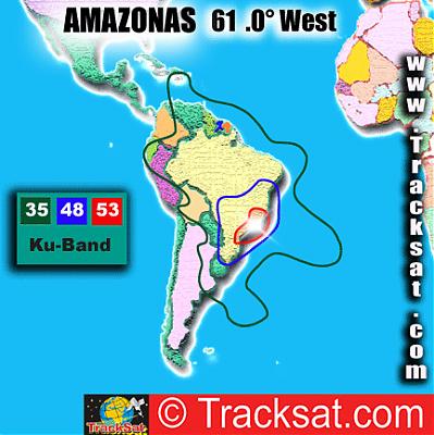

Sunday, June 21, 2009 - 02:59 GMT Thanks for your answer but lyngsat says its americas and it looks like its quite close to 61.5 dishpointer directs to the elevation etc unanswered question is the lnb?

Sunday, June 21, 2009 - 03:15 GMT Bazuka If you live in Florida with a 6' dish maybe you can get few channels, this bird is for South America, you must have a linear LNB for get this bird. Look the Map:

Sunday, June 21, 2009 - 03:30 GMT U r right thanks

Sunday, June 21, 2009 - 03:39 GMT Florida! even with a 12 f. couldn't get telefonica, It's Ku band,
