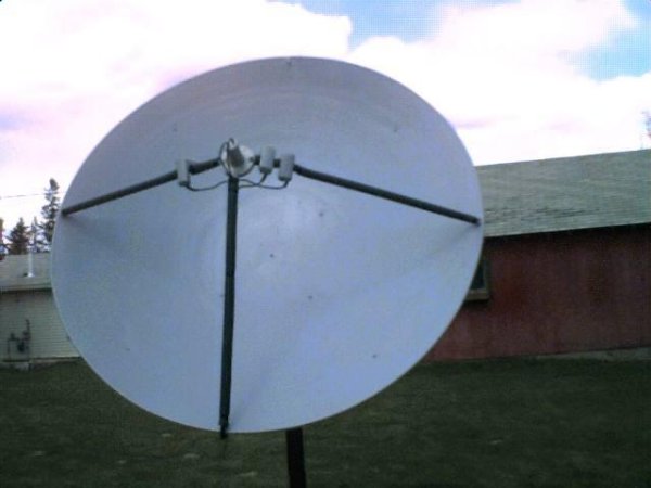

Username: King_of_sats
Post Number: 982
Quick and easy for buds works like a champ I have simlar setup on a 10' mesh
