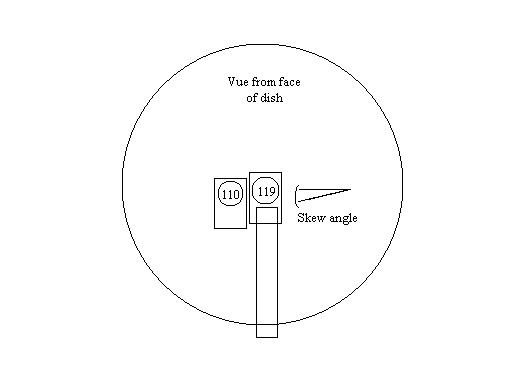

i have a reg. size dish, 20" or whatever, with a dual LNB (110,119), but the LNB holder the 110 is straight and the one for 119 is kinda on an angle....works great......now my problem is i am helping my bud do his sat....but the LNB holder is different then mine, both are straight.....now the 110 we get a signal, q80% s60%.....but for the 119 we get nothing.....now is it because of the LNB???

No you must have a angle, if you can use a Hose clamp for fix the other LNB.
Look this picture and fix it side to side and play up and down until you get the best signal.
