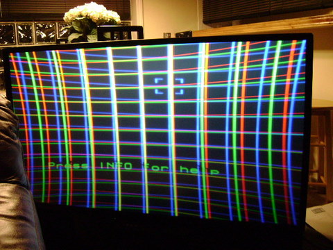

i have thsi projection tv and the convergence is all messed up and the screen is bowed severely top and bottom....all conv resistors checked ok all pico fuses checked ok i then repalced the stk 392-040 with new ones and the exact same problem exists no difference......i then noticed that the convergence ics stay cold when having the tv on for any length of time..???
the convergnce does not move at all in normal conv mode and even in service mode..nothing is able to move at all in any direction
can anyone help me..i do have picstures if needed........there is a board called conv gene board that i have seen references to but not sure what it does or if it would have anytghing to do with my issue......

i mean bowed side to side severely and some top/bottom
Username: Shelby5041
Registered: Jan-09
actually its bowed on all sides..pretty bad..

it's called pincushioning.
not sure what to say to that conv issue though.. that is pretty awful.
