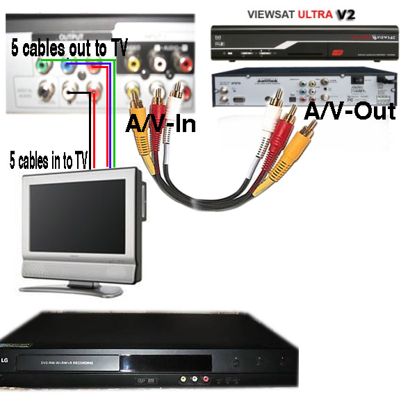

Username: Tapeman
New York City in-HD, NY
Post Number: 3463
Better Off Red
Yor connection is wrong
David Massey tried to tell yo that
Yo can't connect reciver to TV and from TV to recorder
Yo have to connect Receiver to Recorder and out of recorder to TV
A matching Input from remote must be selected so yo can watch from recorder to TV
Follow my diagram:
This recorder is a progressive scan output
i.e.
5 Cables (component out) must be connected from receorder to TV

What happened BOR? Did it work this time?
Username: Shadycove
Post Number: 198
yes i just finished tapeing and it works great...thank you all...it seems very simple now
