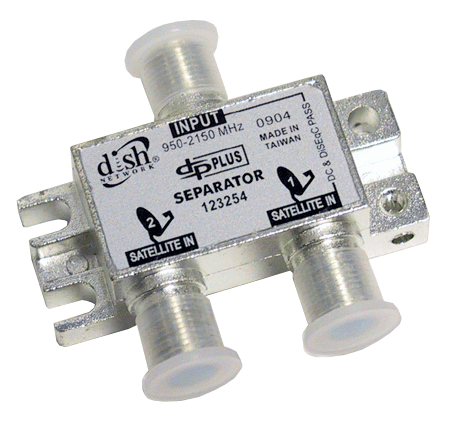

Username: Tapeman
New York City in-HD, NY
Post Number: 3411
I'm trying tio give yo an idea
This is called stacker seperator
It only works with DP-Plus and DP34 or DP44
- It combines 2 satellites to one output
- Yo run only one cable inside the house
- Then use another seperator to split to 2 coax
- This is commenly used for dual tuners to reach rooms that has one connection
BUT IT REQUIRES DPP34 OR DP44 AND DPP LNBF
It changes the voltage from 13/18V to 20 Volts on one coaxial then yo split to 2 independent coax for 2 tuners
I'm bringing this point to show that hardware compatibility is the issue here
