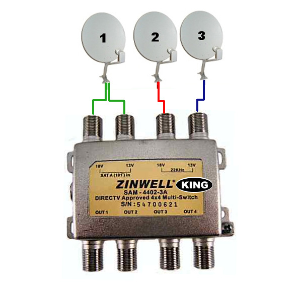

This is the easist way for 2 satellites to 4 receivers
Switch under $20 on e-bay
Yo can use 3 satellites like this
Sat-1 will be available on all receivers
Vertical polarity only from Sat-2
Horizontal polarity from Sat-3

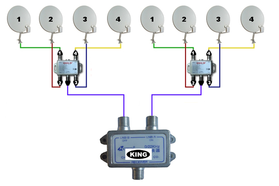

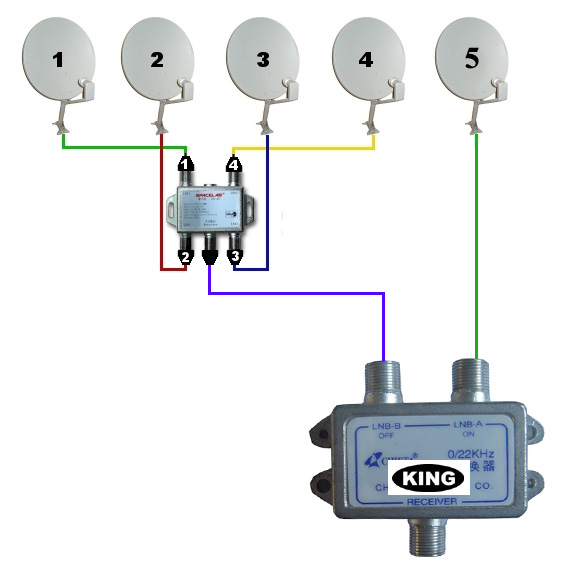

If yor more advanced installer yo can add 2 more 22k switch and combine the other 2 polarities
This is 5 satellites on one receiver
This is 8 satellites on one receivers

King Tapeman you say that Vertical polarity only from Sat-2
The drawing of the Zinwell 4x4 Multi Switch shows Sat-2 connected to the 18 volt port. 18 volts is for horizontal polarity, and 13 volts for vertical polarity. Please correct your post.
