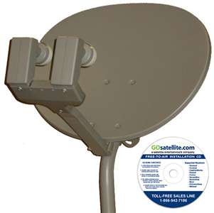

this what i have
Username: Tapeman
New York City in-HD, NY
Post Number: 2860
Bingo
That's all yo need for 61/82
Looking in front of dish 82 is on right, 61 on left

Another thing yo can do with that dish
Yo can add a Universal LNB in the Middle
Like Digiwave DGL-1189S
or Orion Ku2LP $20 from e-bay
Yo can get 110/118/119/129 that's a total of 4 satellites on one dish
Ask any question yo want

These are the settings for Calgary
Magn Azmith= 115°
Skew Angle = 64°
Elevation = 19°
Facing dish
Very important to use 61.5 left LNB
82 is right LNB
61 will be slightly higher than 82
Almost 61 at 10 O'clock and 82 will be 4 O'clock position
Step-3 for 61.5
Antenna setup select LNB Universal
Select third TP or any active TP
cover 82 with like a paper cup
Start moving dish to get 61 on LNB
Once yo get 61 uncover 82
Step-4
Apply similar settings to 82
Yo might have to set/reset 22K sw in antenna settings
DTV use 22k on set 1-LNB and 22k off to reset the other
It's not that hard but that's 22k driver selector it's an ON/OFF
Additional tweek in skew maybe needed for stronger Q signal level
With that dish yo can enjoy both 61/82 HD
