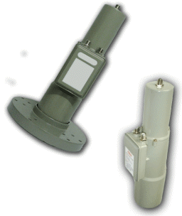

C Band Input 3.4~4.2 GHz Output 950~1750 MHz LO 5150 MHz Gain 65 dB Ku Band Input 10.7~12.75 GHz Output 950~1950 MHz Low band 1100~2150 MHz High band LO 9.75 GHz Low band 10.6 GHz High band Noise 0.3 dB Reference http://wsidigital.com/bsc621.htm

Keep in mind the BSC-621-2 has c/ku though the ku-band is universal good for Intelsat-9 ku-band, this unit will not work with 4dtv, for that you would need to use the BSC-621.
If you do want to go with a low cost lnbf I would get the Geosat c/ku lnbf, as many people find it better than the BSC-621 models.
