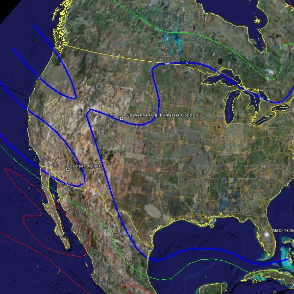

Tuesday, April 29, 2008 - 22:54 GMT Where are you located Sada (city) The good Tp is 12297

Tuesday, April 29, 2008 - 23:00 GMT calgary canada

Tuesday, April 29, 2008 - 23:16 GMT Sada i think you are out of zone You can try Tp 12414 This the Tp for installer

Tuesday, April 29, 2008 - 23:24 GMT You need dish 110 cm for your location http://www.dishpointer.com/satellites/

Wednesday, April 30, 2008 - 02:03 GMT Sada, forget it you are not going to get it if the elevation is showing as 14 you will not get 61.5 sorry

Wednesday, April 30, 2008 - 12:44 GMT sada From your location @ 14 degree elevation you will need a clear line of sight and a 36" to 48" Dish.

Wednesday, April 30, 2008 - 15:34 GMT ok thanks a lot.. i have 18 inch dish.. so it won't work thanks again all you guys for help
