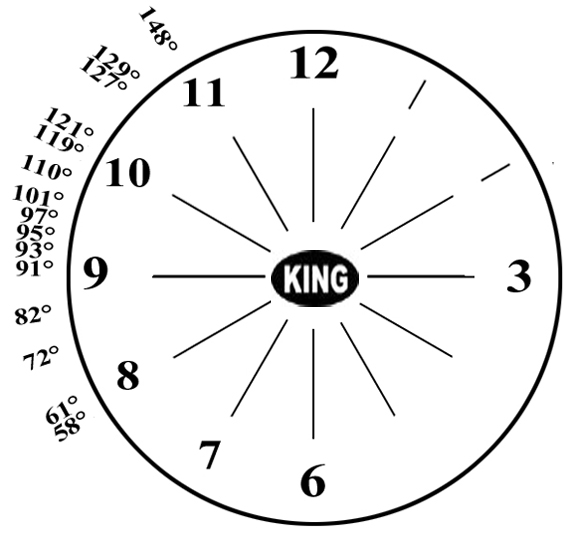

Perhaps about one half of an inch tweek plus slight up or down depending on where yo live a compass and http://satcalculator.freehostia.com will be helpful
or print this and put it on your pole to use as a compass
