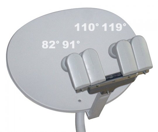

king again yo post and prove how little yo actually know. The following setup will work:
1 - 18" x 24" Eliptical Dish
4 - Dual LNB's
1 - 5 port LNB Mount/Yoke
1 - Disc Switch (4 in /1 Out)
Arrange and mount the LNB's on the pre-engineered 5 point Yoke, so that the 101W LNB area is not populated (i.e., is empty) then mount the 4 LNB's, in their respective places. You'll be able to scan 91W, 82W, 110W and 119W without having to move the dish at all (no motor).
Once you lock onto 91W the others are automatically 99% there.

Username: Tapeman
New York City in-HD, NY
Post Number: 2706
Well Mr. Soprano, a real person not a paid celeberty
Yo are advising a member to use 24" dish
4 LNBs and 5 port mount
I can see yo never tried it
Well yo think about it
Picking a signal from around South to South West with a 24" dish only under 45 degrees WOOOOOOOOO
TEACH MAN I can use all the help I can get
This is the most impressive advice dude
