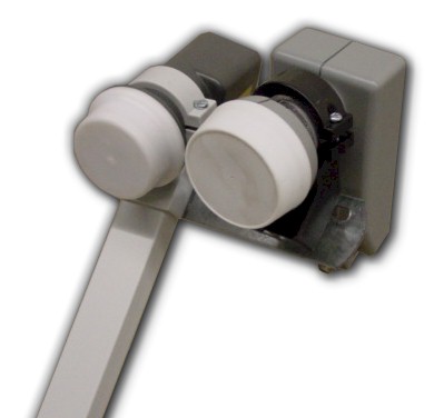

Username: One_eye_jack
Post Number: 383
Registered: Nov-07
W first you will need to buy (1) LNB DGL-1189s
and (1) two holder bracket.
Put the new LNB in the center & the existing LNB for 121 to the side of the bracket.
For more info. read this thread.
