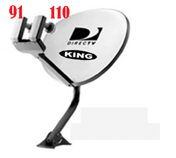

- DTV phase III can not and will not get 82 and 91 at same time
- DTV phase III can not and will not get 110 and 119 at same time
The reason middle LNB picks up only freq above 12.5GHz
So this means if yo are lucky might pickup 2 to 3 TPs at best
DTV PhaseIII was designed for 101/110/119
DTV only use few tps off 110
What I would do if I were yo
- Point middle LNB to 101
- This will line up 1-side LNB to 91 and 1-other side LNB to 110
- This will allow yo to pick up 1-DN (110) and 1-BEV (91)
- Other than that won't get much usage out of PhaseIII dish
Ponting and skew:
Very critical
- So go to http://satcalculator.freehostia.com/
- select multiple sats at least 91/110 alnog with your region
- Set Skew, Elev, azmith to calculated values
- Temp Put a paper cup on middle LNB as it is usless
By looking at front of dish
- Try to move dish side to side line up right LNB to 110 and Left LNB to 91
- With patient pointing yo'll get both
Come back tell me how it worked

yep
Either one of the side LNB should get yo 91w
70% is good enough
