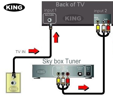

I have just purchased a Samsung LE40R8 lcd tv and want to use the PIP function.I have a standard Pace Sky + box and would like to know how I can connect it so PIP will work.
Username: Tapeman
New York City in-HD, NY
Post Number: 2232
PIP require 2 separate tuners
Any 2 tuners
Cable Box or Satellite is one tuner
If yo got cable straight from the yo can split it and use it as a second tuner
Other method if yo got digital cable box that may have PIP with 2 tuners built in

yes but how do I connect up as the sky box is only scart and PIP will not work on this tv with scart.

Username: Tapeman
Post Number: 2248
Michael based on the information yo provided and based on PIP requirments:
- PIP must have 2 tuners
- Yo can use coax cable directly to TV as tuner#1
- But since yo need a second tuner I don't know if sky box has RCA out (Yellow/Red/White)
If it does then that will be your second input tuner#2
Let me know if this works for yo:
Good luck

There is no RCA out but there is a s video connection?
Username: Tapeman
Post Number: 2255
Yo can use S-video instead of yellow
Keep in mind
S-Video is just video plus (red and white for audio)
Audio can also be fiber optic (1-wire L/R) if no RCA
In any case
PIP requires 2 tuners
OTA Antenna or basic cable out of the wall can go straight to TV this will be one of 2 tuners the second is the additional box
Yo can also use VCR or DVR as a second tuner if yo got one
