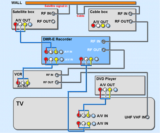

Although I don't have a VCR, I will use this set up I found at the Panasonic website.

This set up did NOT work.
Tell me what I am doing that is wrong:
I have a TV, a DVD recorder, a viewsat, and a cablebox.
1. Cablebox and viewsat connected to RF in with respective wall sources
2. Cablebox RF out to RF IN into the DVD recorder.
3. DVD recorder RF OUT to Back of TV UHF VHF IN.
4.Satellite box AV OUT (red, white, and yellow) to DVD recorder AV IN.
5. DVD AV out to AV IN into the back of TV.
After turning all on, the Satellite image does not appear on TV. Only the cablebox image appears on the TV.
I disconnected the satelite going to the DVD recorder and plugged in straight to the TV. However I will not be able to record from the satellite. I can only record from the cablebox.
Does anyone have another chart that I can follow?

Go back to your original configuration, switch your TV to monitor mode or something like it - making it a dumb monitor - to view your satellite image.

Thanks for your quick response. I tried everything but I can't record from satellite.

To record on your DVD recorder, you have to change the source it uses.
I have a JVC DVD recorder and I can record from either the cable or my VCR or my camcorder.

Connect everything with s-video or RCA cables. Never use coax unless there's no other way, video quality will be inferior and audio will be mono. Use the line inputs and set the recorder on whatever input you used. If there isn't an input button on the remote, go through the channels until you find the right input.
If the recorder takes 10 seconds every time, it's defective. There are some functions that take awhile and the recorder won't respond until it's done with the task. I.E. when recording stops it has to write info to the disc before it will do anything.

If the cable box and/or satellite have s-video out, that is the best way to connect, but depending on the sat and cable box quality, there may or may not be a difference between s-video and RCAs. If you don't need the absolute best record quality, RCAs will do fine.
You need to be sure you are on the right input when you record is the main thing. When you see what you want to record on the TV when the TV is on the DVD recorder input, you're good to go.
