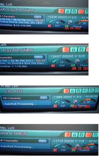

the latest bin work perfectly excellent on 110 and 119, but when it comes to 118, the S/Q is there strong, but the screen just showed AUTO ROLL PROCESSING.
if my set up is not right, I shall not able to scan the channels in in the first place, and if the bin is not working good, the 110/119 work awfully well, why is it just 118 on auto rolling?

here is a pic I just took, the ppv on 110/119 work perfect, but some channels I pick from 118 just keep on rolling.

I just tried set the tp at 11715/20000/auto/auto this time, and the channels on 11715 came to be on H instead of V(I was setting at) this time, but still auto rolling.
