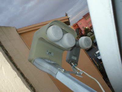

can i use one dish for Dishnetwork to get 61.5, 118.7 and 110, 119
right now i only have scanned echo 7 (110) and echo 8 (119)???
will i get more channels with 61.5 and 118.7?

Island Tv : You are getting very ambititious.
Look at Digiwave 18 x 30 Dish with 5 LNBs and 8 to 1 switch.
I do not have this, so you will have to rely on yourself or other help.

Username: Nydas
Post Number: 7498
barry orear : Read the post above. I just categorically stated with the name as well (Digiwave) 18 x 24 and 18 x 30 which take 5 LNBs on one bracket.
I have seen it with my own eyes. So what point are your trying to make by saying "there are no dishes made"?

Username: Nydas
Post Number: 7500
The Digiwave dish will take 82w to 119w.
You can't get 61.5 W with it at the same time.
The 18 x 30 can take a universal LNB to take in 118.7 and 119. Then you would not need to scan 61.5.
Username: Madflea168
Post Number: 95
dn is about to move international to 118.
you get HD and some international on 61.5
you can convert super d with a repoint kit (2 lnb) to get 118/119/110 and option of extra lnb to get 129 (hd channels)
it will be little tricky to scan the 118, took me a while to get it.
