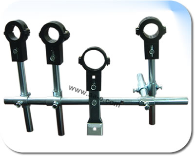

i have this bracket and i did not use it
if i want to use 118.7 and 97 which position i have to put lnb

That's not gonna work honey
20 degrees apart U need 100 CM dish

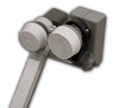

Pizza
Like Nalin said, you can get all three birds on your 90cm dish. You will need a Linear LNB for bird 97 and 118° (Circular 10750) dual LNB
Receive both 118°W and 119°W with 1 LNB
And one bracket
