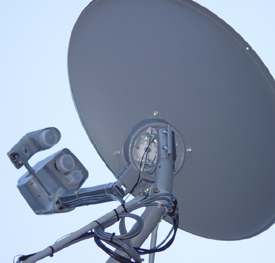

Username: Locnoir
Post Number: 35
Nalin, this is what I have on the roof. What should I do to get 118.7 (Anik F3)? It is not listed in the antenna setup! Thanks

Username: Locnoir
Post Number: 37
Nalin, please look at the photo on post# 35 above. The sat was installed by DN. The dual NLB is for 110 and 119, and the single NLB is for 105. I live in east coast. How can I get 118.7 Anik F-3 which is not listed in the antenna setting of my PS 2700 converted box? Thanks
Username: Nydas
Post Number: 6939
DN lnbs will not pick up both unless you buy the official conversion. I do not know the LNBs you are showing in the picture.......They migh give you a weaker signal by 3 DB
......Even if you pick up an unknown satellite in antenna setup, you will be scanning the sat you are pointing to and connected in the DisEqC switch.
Just make sure that the LNB freq, switch settings and LNB type (universal) are correctly set. Then do a Power scan (Blind scan).
