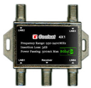

how is this connected?

k my 61.5 is on #1
and the other 119 is on #2
Username: Ke5aqn
Post Number: 3153
Cool adjust the antenna settings to represent that.

go there again,i see that you have both set on port 2.you need to change 61.5 to port 1,
try this and if you need more help then post on this same thread
Username: Parthp18
Toronto, Ontario Canada
Post Number: 17
Afrcian it works now all becuz of u yayayaayayayya thanks man!
