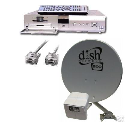

nike if you was using a disqc with a dishpro and it was working you was lucky.....
a dp34 is what you use to add another lnb to the dishpro lnb.
this pic is how it works even with one receiver like yours..

Yes, I have a DP 500 as the pic above, It has two Connections one for 119 and the other for 110. I was using a disEQC switch earlier with these like i said before and they were working fine in port 2/3. (Its a 4 port DisEQC switch) when i moved the switch stopped working. So i am currently only connected to 119 direct from lnb to receiever.
