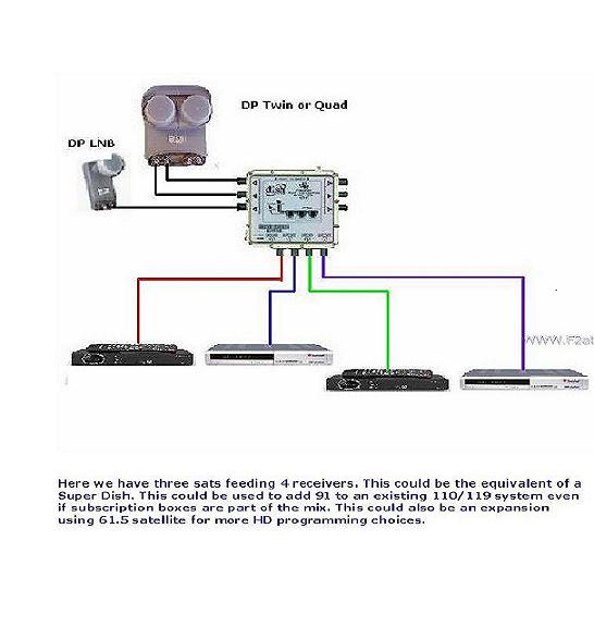

I think its not the receiver giving you trouble..
if its a dishpro lnb for 110-119 you can not use the disqc switch with it. you have to use the dp34 switch its made to add anther lnb to the dishpro lnb
drawing is how to set it up with just one receiver in your case
this

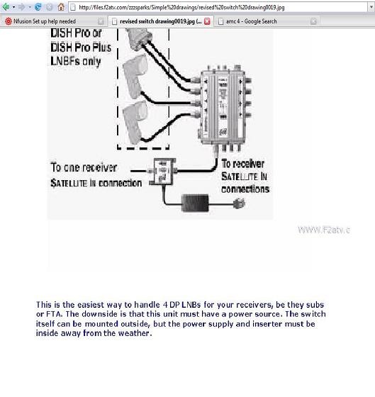

now i see you have 2 dish pro's i have the drawing for that too hang on a min
Username: Ke5aqn
Post Number: 2578
here is what I found its more complex and will require a powered switch to be able to control the 2 dishpro lnb's....i woul go find a single lnb instead
