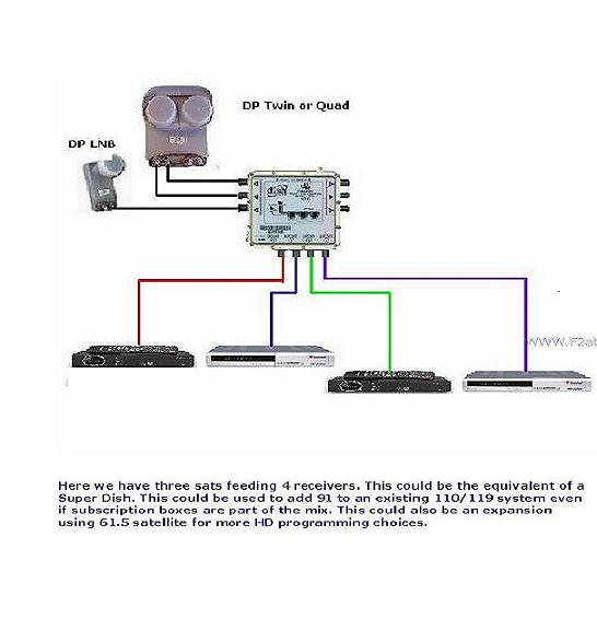

The deal is the dish 500 has a Diseqc built in and is made for 2 receivers to use and get both 110 and 119. The the ports out on that lnb are for 2 recivers not 110 and 119.
So if you put a Diseqc switch inline with a dish500 everthing gets confused and it will act JUST LIKE YOUR IS. Your receiver can not control 2 Diseqc switches.
What you need is a DP34 it is the switch designed to add a LNB for another satellite to the dish 500 system.
The way you connect it is like this:
out from the receiver to the DP34, uot the DP34 to dish500 ONCE, out the DP34 to the 61.5 sat's LNB...............thats it

i want use one cable from dish 500 and one is from dish 300 .i want dish 500 work for me 110 119 and dish 300 for 148
Username: Ke5aqn
Post Number: 2341
thats fine you still have to use a dp34
you can not use a regular disteq switch with a dish500 or dish pro
in the end it will be 1 coax from receiver to switch, one coax each antenna.
