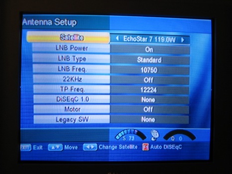

Username: Dharm_ram
Post Number: 88
Viewsat ultra
sat - echostar 7
LNB - STANDARD
LNB FRE - 10750
TP FREQ - 12224
DISEqC 1.0 - None

Username: Dharm_ram
Post Number: 90
are these signals fine?
Username: Ke5aqn
Post Number: 2345
Well no
You have no qualty! what satellite is the antenna pointed to in the sky?

Username: Merk
Post Number: 28
mine is working with this for e7
lnb freq 11250
tp freq 12239
Username: Ke5aqn
Post Number: 2347
Change lnb frequency to 11250 and lets see if you can get quality..

Username: Dharm_ram
Post Number: 92
already tried..nothing works...
Username: Ke5aqn
Post Number: 2348
12224 is a active transponder. I get 100% sig and 100% quality on it.

Username: Ke5aqn
Post Number: 2349
so you put the lnb back to the correct 11250?
put it on that and keep it on that. no other setting in that feild will work.
If you do and still have no quality you need to make sure you antenna is pointed correctly....

set up like this:
sat - echostar 7
LNB - STANDARD
LNB FRE - 11250
TP FREQ - 12239
then put it on channel 200 let it roll
Username: Ke5aqn
Post Number: 2351
did you try that transponder 12239 for 119 echostar 7?
That transponder is active as well as 12224
set the antenna settings at
echostar 7
lnb power on
lnb type standard
lnb high 11250
lnb low 9750
tp frequency 12224
diseqc off
motor off
legany SW none
Make sure all connections are tight
if still no quality
go to www.dishpointer.com
adjust all fields to your location and that sat
and read the sugested direction and tilt settings then cheak to see if antenna matches
