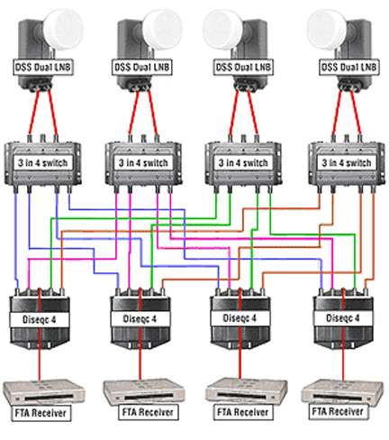

6x8 Switch
Or Cascade your own like this diagram

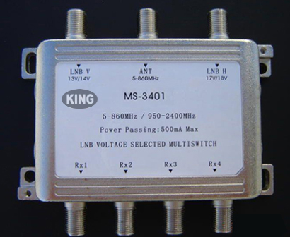

4x4 multiswitch
Is for 2 satellite connecting 4 recivers

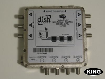

DP34
This Switch Combines 3 Orbital Locations to power 4 Receiver Outputs
-Three inputs to capture signals from three satellite orbital locations (61.5°, 105°, 110°, or 119°)
-Four outputs for connection to four receivers,
-Three direct feeds to connect to other DP34 switches.
-Up to three DP34 Switches can be connected to run up to 12 receivers.
-Switch is usually powered by receiver.
But may require additional DC power Source.
