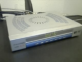

Hello,
Someone just gave me this old pantec-ms with a serial cable. till working but can't watch any channels. System info. shows X-85BL API:286Ta_EU. I need some infomation and advices for what i am supposed to do with it.
I appreciate your help and infomation!

That box can be converted to a Pansat 2700, visit the below link for info......
http://www.ftabins.net/forumdisplay.php?f=122

Thank you very much, Iroy. It works great. But still have one more question. Does it mean that my box can load any pansat2700 BIN files from now on?

The answer is NO, you must use the file for the converted box, like Jvvh_Leafs(BG)_224.bin, CS_224T_Lightning_100t_Series_serial.bin, these are modified, compressed 2700 files.
