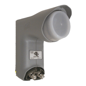

what is a dish pro lnb? ive got an older one from my dave days would that work?
and thanks again LK

NO...dish pro LNB actually says "Dish Pro" on it...
$19.99 below

ok, the satelitte store actually said NO to me buying a new lnb. how weird is that.
they said if my lnb worked with 110 or 119 9w (which it did) it'll work with 82.

well, it definately works with a standard lnb. got 82 working just fine. as "type" i just put in "single".
Username: Lklives
Post Number: 13666
Since U have a dish pro switch, it made sense u should stay constant and use all dish pro LNB's...what If U want to add more LNB's with a DP switch later...and of course U needed another LNB if U wanted to add another satellite..
